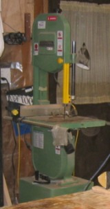

I have an 18" Rikon, which I use for both large and small work. If I was to buy now, I'd get the Rikon 14" Deluxe saw. It actually has a slightly larger resaw capacity, a smaller footprint in the shop, and better blade guides. If I wanted to keep costs down, I'd look for one of the used saws mentioned above. If I ever get a larger shop, I'll get one of those and keep a resaw blade on the 18", and an 1/8 or 1/4" blade on the small saw for tight curves.

I've got an 18" Jet bandsaw. If it was stolen I'd get another one just like it, and maybe put out a hit on the guy who stole the first one.
